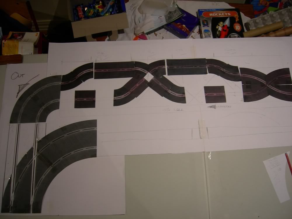

After searching high and low for ideas I have started the design process for my Pit Lane for Kahoona Mountain. As today has been a typical barmy day in Melbourne I though I would have my first crack at putting pen to paper. Any feedback would be greatly appreciated.

Hi Andy,
I will incorporate the same Idea into my Carrera track.
Will be a while before I reach that stage,
I asume, you found that german website, which discribed it step by step.
I thought about putting a routed piece of wood after the in/out junction parts,
but I have enough space for 2 crossing sectionin between.
Keep the photos coming.

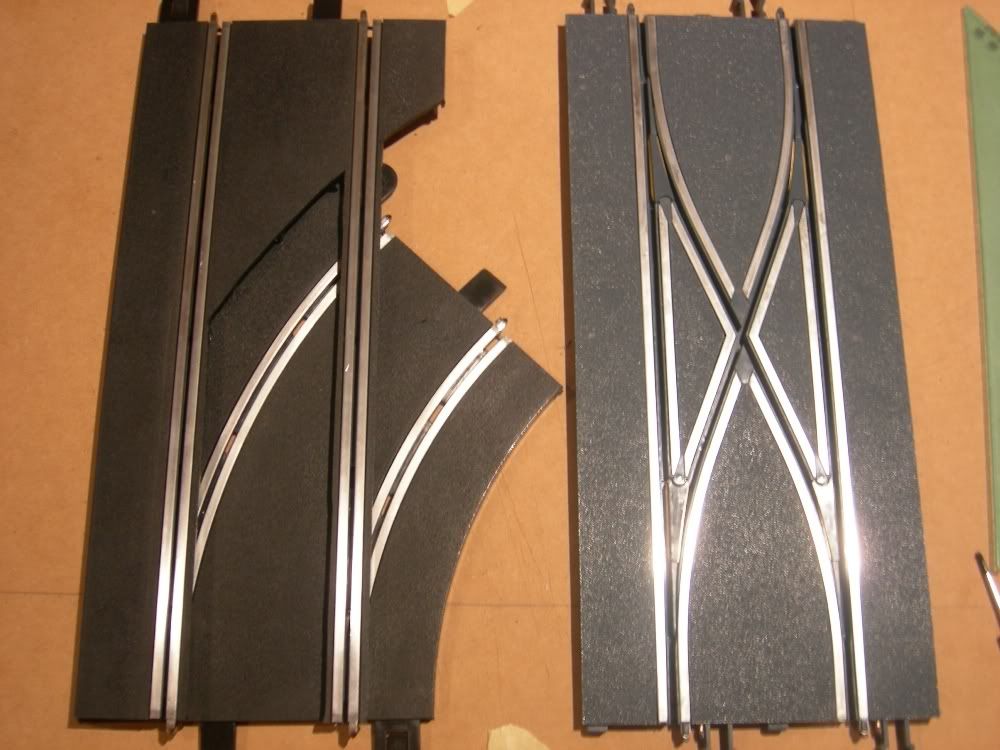

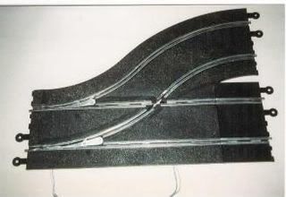

Did this a couple of years ago, thought the pics may help.
I used Artin track cos' I love the stuff.
Here is one I did earlier.
Some pics of it all together
NimROD

nice work there Vlad! very neat!

BTW I used a two part epoxy to stick all the pieces together.
I aligned all the parts face down on some industrial clear plastic the wouldn't allow the epoxy to stick to it.
I used nails around the edges of the pieces to hold them in the correct alignment, then covered all the joints with epoxy and weighed it down with an old phone book, then left it for 24 hours.
I look forward to seeing your results and final track layout.

Due to poor health again moving my office, designing the train level crossing and coming to the conclusion that plain straignts (2 x Full, 1 x Half, 1 x Quarter) did not give the pit lane due justice I have come with up a more interesting design, picture to come. The dilema is that I need two straights one 210mm and one 160mm half track width.
Does anyone have any thoughts on what the most effecitve method would be to cut and shut a piece to allow retaining the connections at each end.
Andy

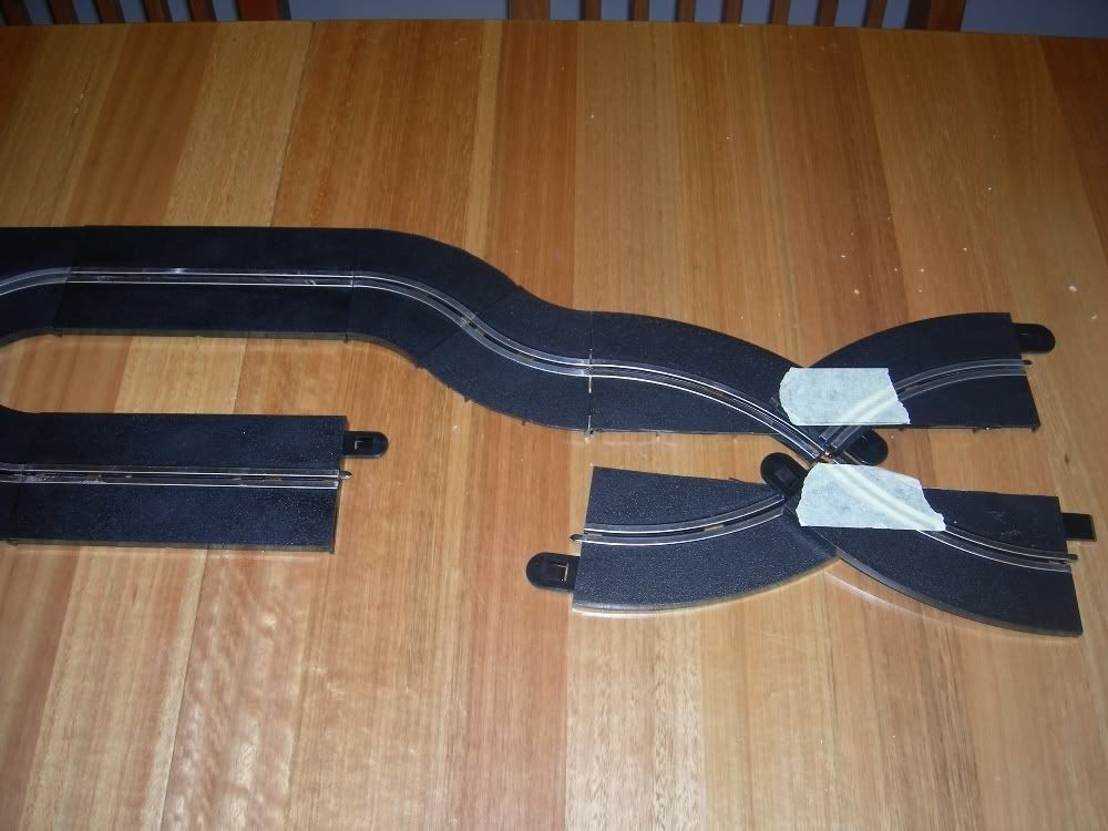

Made some progress watching the L&H it was a shame the day was spoiled with 10 laps to go :)

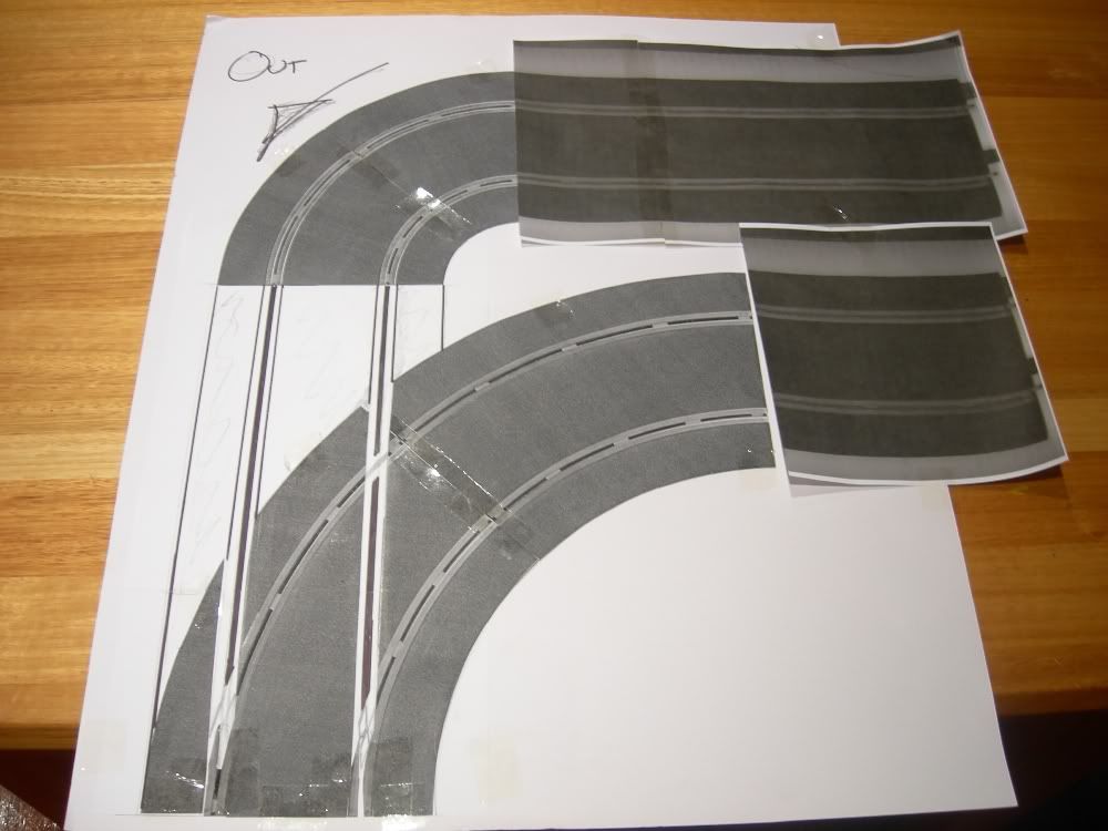

The drawing of the pit lane concept before the cutting started
Cutting progress

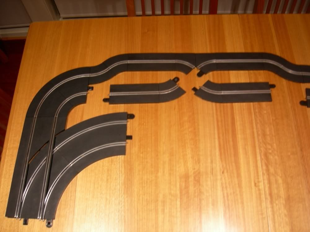

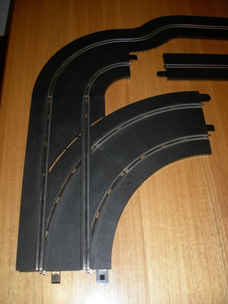

Cut both the In & Out sections before cutting the R2 curves, better quarantine this to the workshop as I will need to fire up the Dremmel
General concept of the pit lane minus the chicane as you come out of the R1 curves (not shown)

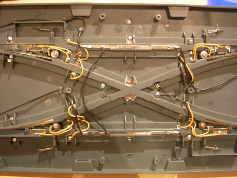

Picked up this SCX digital lane changer which is being considered for flippers and mechanisim
The spaghetti behind the scx piece is there an electrician in the house :)
Once I have got this part under control more cutting will commence, pictures of the level crossing for the trains to come.
Any feedback will be greatly appreciated
Andy :)

Mate thanks for the kind remarks I have spent a fair bit of time researching and planning a lot of the guys on the forum have been very helpful in supporting the project as well. I completed the center chicanne tonight hopefully I will get into the one at the start of the pit lane tomorrow.
I will keep posting photos as I go along.
