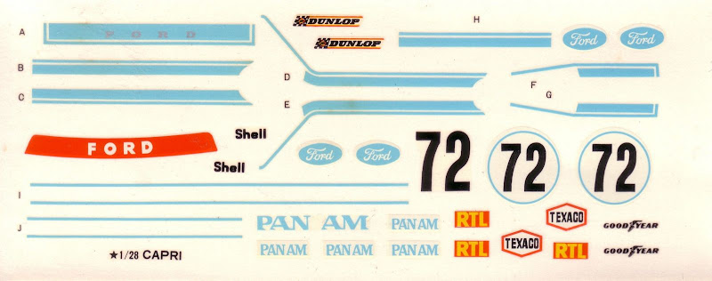

If it helps, I have a 1:28 plasitc kit (Nitto?) I have not built yet of a works car. The detail is not as good as a Tamiya kit, but it comes with a sheet of decals including blue Pan Am lettering and wide and narrow stripes to be applied to the white body. The blue is the wrong shade but if it helps anybody I can scan it.
I also have good quality images of the car in AM's workshop if you want to see close-ups of some of the sponsors signage.
Let me know.

Hi KarKraft.....Any help would be appreciated, especially in the decal area. If you could scan your decals it would be very useful.
Alan

Obviously the sponsors are wrong, but AM's car had a 'Goodyear' on the rear of the spoiler, a Ford 'Oval' between the tail lights and a 'Motorcraft' between the oil coolers in the rear beaver panel.
Here are the decals, but I now notice they are basically stripes only:
