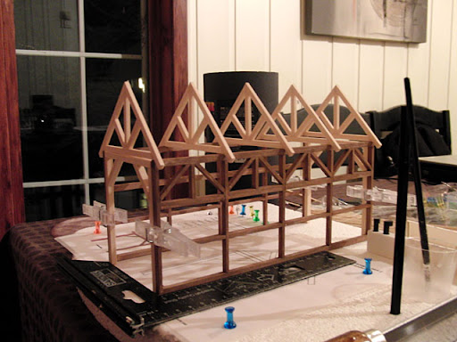

Lot to learn from the diorama and railroad guys :)
They build most of the buildings from either laser cut wood kits or from scratch using "scale lumber"
Here's my first attempt from some time ago
It's fun but takes time, so it's not finished yet :)
