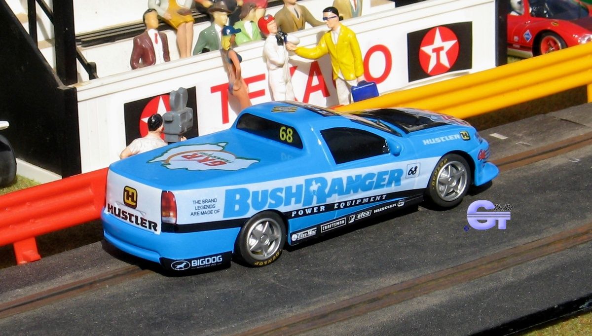

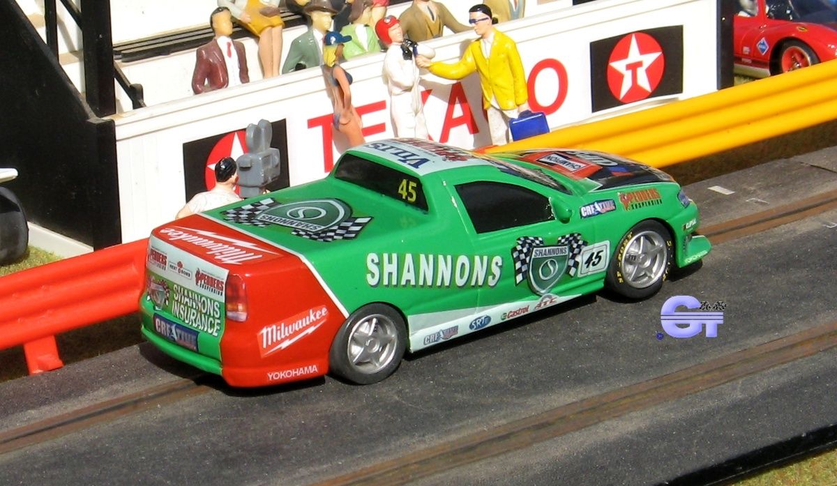

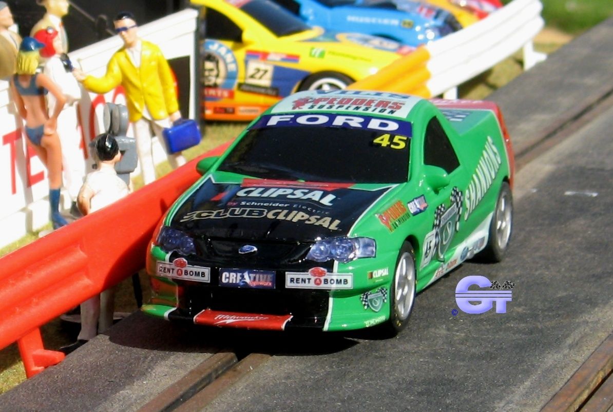

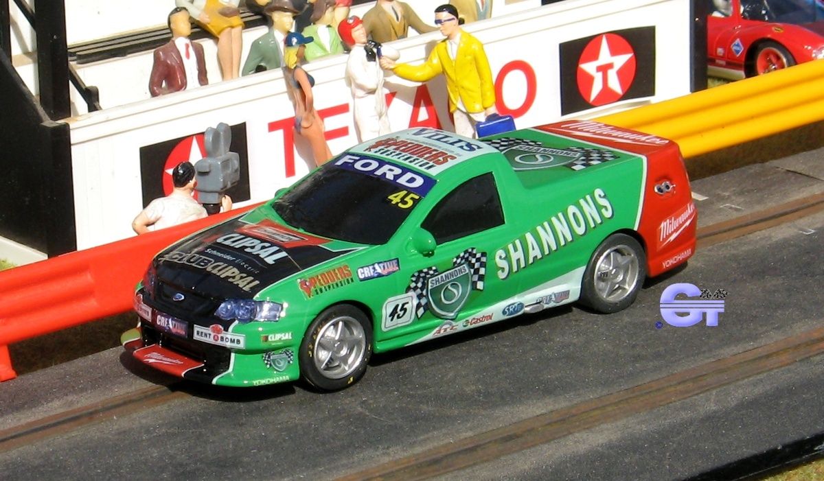

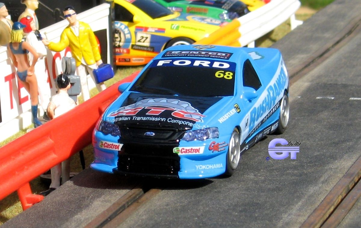

Just thought I'd show off my latest V8 Ute builds. Two BA Utes in Shannons and Bushranger liveries. The bonnet decals have proved problematic, so may need to mask and paint them next time, although that is not my strong suit.
The next build will be in red and black Milwaukee livery. I've still got some BA and VY resin ute bodies left over, if anyone here is interested ($15 each), and will eventually put a couple up on ebay as well, see how that goes. Maybe even do a full livery and see if it will sell, although there's a lot of time goes into each one, as I'm sure many of you would already know.
