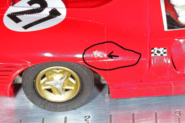

  • 205 posts
  • Location:Warkworth
Posted 21 June 2019 - 10:08 AM
Mine is good apart from one small blemish.
