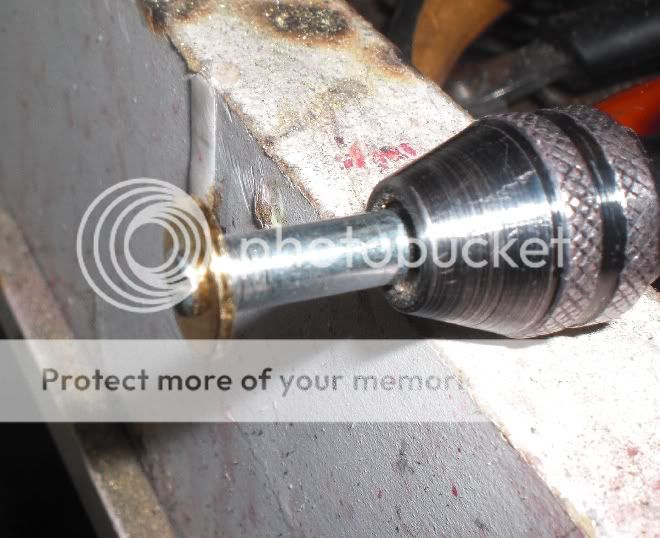

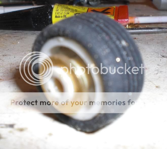

Ben you should first reinforce the wheel centers,they are subject to cracking
Here is what i did for the Skoda

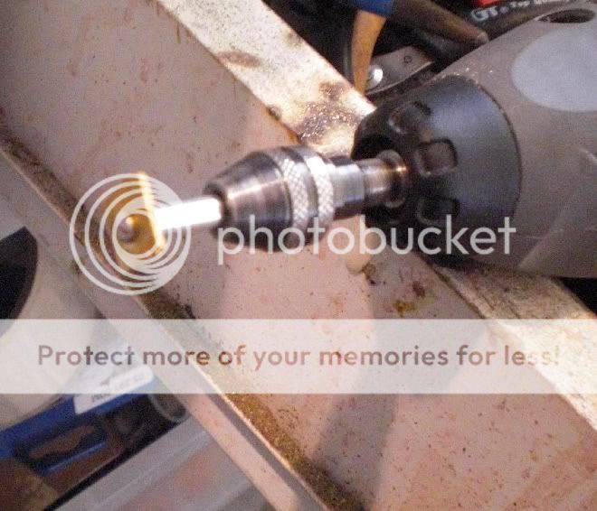

I cut a piece of 1mm brass sheet 4-5 mm bigger than the dia of wheel center,in this case wheel center is 6 so i cut 11x11.Drilled a hole 1,75 mm as centered as i could then mounted the piece on the dremel axle we usually mount the cutting disk on.
I filed the square down to a disk of 10mm dia.

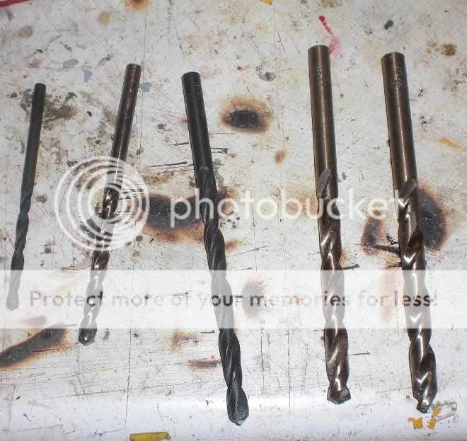

Then drilled the disk.The tricky part is this:i used 5 bits 3mm,4mm,4.75,5.5,6 one after the other because it is very difficult to hold the tiny disc in place while drilling.In reality a 6mm bit gives a 5.6-5.7 mm hole which is perfect for the job.The general rule is that the final drill has to be ~.5 mm smaller than the desired dia.
I filed conically the hole to reach the desired dia using a round file,one tiny step at a time,test fitting between steps.When done correctly(i scrapped 4-5 before getting it right) you can press fit the disk over the wheel center.Then
you dont even have to super glue the rim on the axle,i did because they had to last a whole championship.

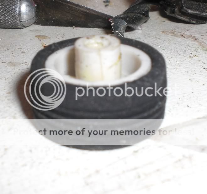

Or just use some brass or ally tube that fits over the hub.

That's why I used ally on mine last year. It has some stretch. I actually forgot to glue the wheels on the axles last year. But I don't think there were any problems. The ally stopped the stretch maybe?
