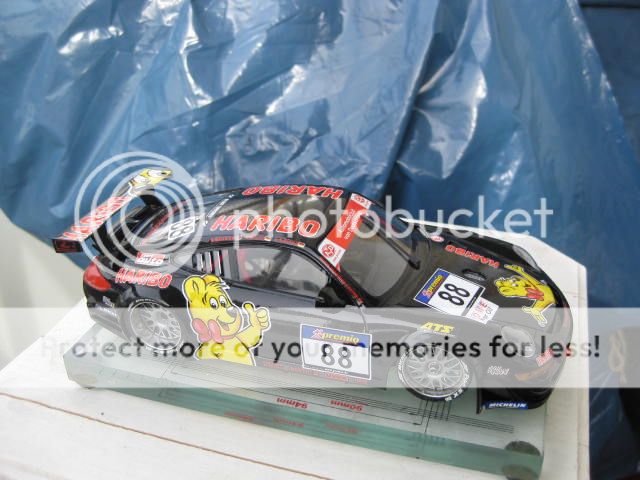

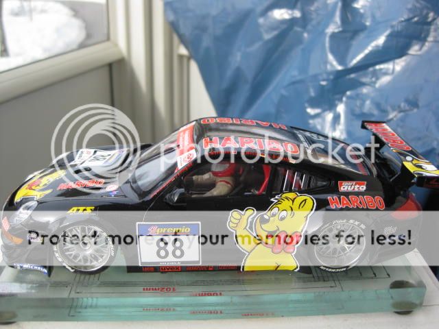

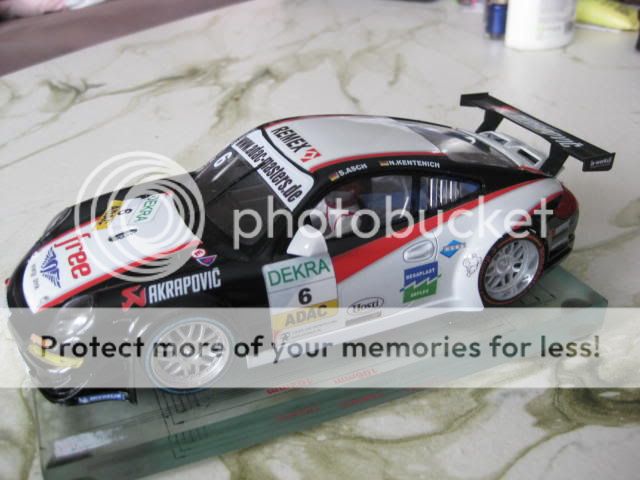

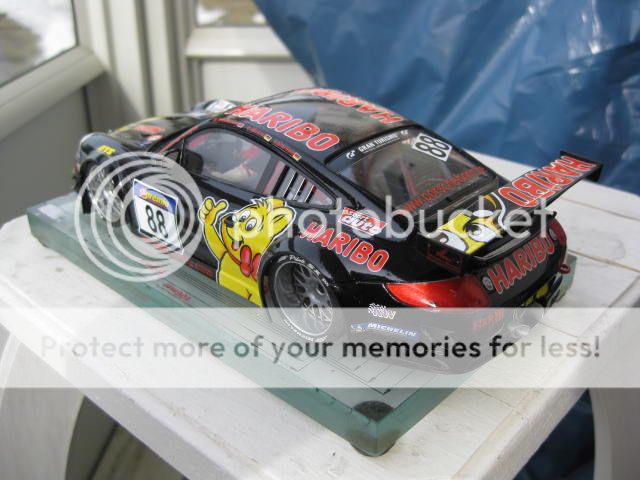

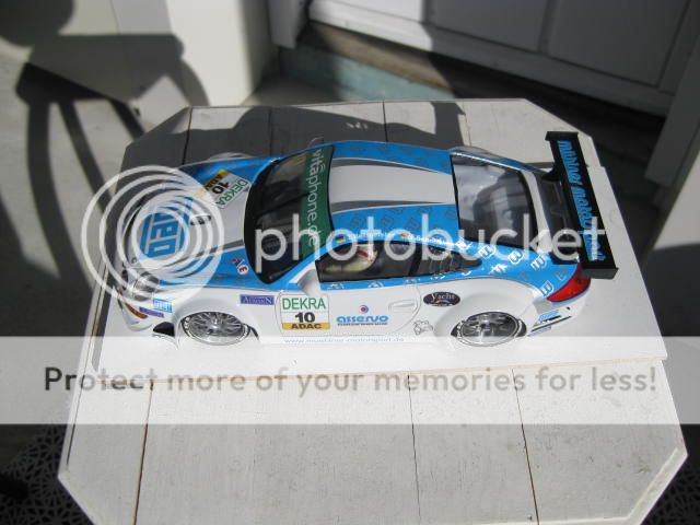

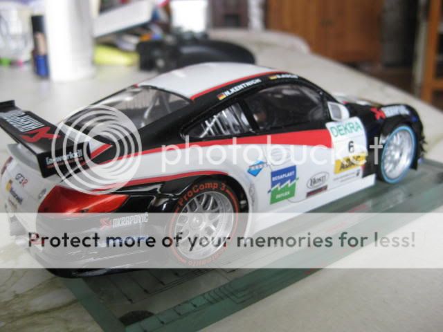

In 2012 we are running in time porsche carrera cup here in Sweden.
The cars that are approved are only scale auto gt3rsr and cars
and is out of the box. What is clear is custom paint jobs or original livery. The tires are hand out pro comp 3 from Scale Auto.
Here are some pictures of various GT3 that I have painted to
different drivers in Sweden.
Christer
Posted ImagePosted ImagePosted ImagePosted ImagePosted ImagePosted Image

Beautiful bodies Christer,love them all.
