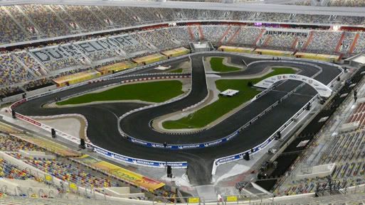

ZeGas 65 Report post Posted December 19, 2011 (edited) I have started a routed track based on the ROC Dusselldorf track 2011 & 2012. The track itself is scaled to exactly 1:32 of original and will be one lane digital chase and catch type system. The slot is following the racing line as best as possible. I will be using the Scorpius Wireless System. The track will be battery powered with a solar recharge and will be storable with it being in three sections. Don't know how to add an image from my hard drive as soon as I find that out I will post up the proposal. Can someone please tell me how to add an image I have read the help and clicked on the image button but it only gives an option to upload from a url. No search hard drive option. Edited December 19, 2011 by ZeGas Quote Cheers Grant ....................................................... Home Track..........Corvette C1 Build..........McLaren M1A Build..........Maserati 300S Build..........Allard J2 Build..........50's Diner..........Iso Griffo A3C 3D Printed Adjustable Chassis..........3D Print Projects If life gives you lemons, take them, free s#!t is cool. Share this post Link to post Share on other sites

ZeGas 65 Report post Posted December 19, 2011 (edited) Thanks Paul. This is the proposal. This is the plan The total size is 3m x 2m. I have made a start by building the bridge. used 4 layers of 3mm MDF to build up 12mm for the vertical curves, screwed and PVA'ed together. The sides are 16mm MDF, the underneath of the tunnel is cardboard. The track is coated with 80 grit sandpaper and spay painted flat black. Edited December 19, 2011 by ZeGas Quote Cheers Grant ....................................................... Home Track..........Corvette C1 Build..........McLaren M1A Build..........Maserati 300S Build..........Allard J2 Build..........50's Diner..........Iso Griffo A3C 3D Printed Adjustable Chassis..........3D Print Projects If life gives you lemons, take them, free s#!t is cool. Share this post Link to post Share on other sites
