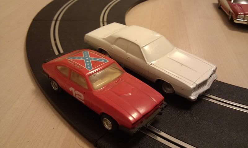

Looks good when it rolls. All four wheels are on the ground here, that's just suspension movement.
Comparing size with Starsky's Torino
Hmmm, something's not right in this picture?

Thanks to ember for the measurements, I've now got an adjustable chassis designed. In other news I've spent the last couple of weeks getting things wrong. After brush painting the bumpers, lights and grille it looked awful so I cleaned the paint off and sprayed it. Then I applied some Maskol fluid and sprayed white over the whole shell. What I should have done is thrown the Maskol fluid as far as I could, possibly with a run-up. So I took the paint back again, sprayed the front and rear silver again and used Tamiya masking tape. That looks much better.
Other things I got wrong, I thought I could keep the resin windows in place like some of the Scalextric cars do, this would keep the shell stronger, save me a stack of work and hide the fact there's no interior. Wrong. So I took the resin out and I'm starting to put the vac formed windows in place. If anyone knows where I can get a roughly-Rosco shaped figure to put in the driving seat I'd love to hear from you.
Finally I got the springs wrong. I had a great idea to use plastic leaf springs because the coils I'd used were too strong. I then found some weaker coil springs which turned out to be very similar to the ones I had a couple of weeks ago! But then some good news, I realised I could soften the springs by moving them inboard; closer to the centre pivot. This afternoon I've been busy filing off the existing spring mounts and fitting new ones.
Pendle came up with the goods for another set of parts so as we stand right now the glue is just drying so hopefully by tomorrow I can have car number 2 on the track with its soft suspension and prove the leaning works. The steering is as before (with some extra clearance) and I'm happy that works.
If it's all good, I can finalise the design changes I've made to the chassis which are:
1. Make the motor pod have better clips for the bearings
2. Change the motor mounts to make it easier to remove the motor
3. Move the springs inboard
4. Add clearance around the axle gear
5. Make the motor pod a little longer because the datasheet I used from Mabuchi has a different shaft to all the slot car motors
6. Make the wheelbase adjustable
7 to 25 just loads of other stuff. Not bad for something that worked ok first time out....
Want to see some pics?
The resin parts including windows
Front axle built up, rear axle built up
Possibly a better view of the improved paint masking, but maybe not. At least it shows the running gear progressed and better wire for the motor!
3D modelling a slot car - Dodge Monaco
